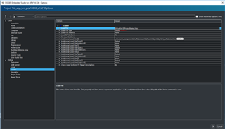

  • Hello, I haven't had any luck replicating this with ses 4.52b. I made sure the __heap_lock and __heap_link part of the lib didn't get discarded by the linker. What I remember from earlier experiments with this is that the problem occurred only for some builds and that unrelated code changes could make it work again. So my guess was that it had to do with code alignment. Have you tried with and without code optimization enabled to see if it leads to the same result?

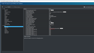

    A possible solution is to make SES program the hex output instead and only load the debug information from the .elf output. Could you try that? The screenshots below show the two project settings you would need to change for this.
    Program the generated *.hex instead of the *.elf file:
    Load debug symbols from *.elf file

  • Thanks Vidar, your magic solved my problem. Setting up SES to program with the hex file, rather than it's default .elf file seemed to solve the problem for me.
    I think we have finally gotten to the root of it.
