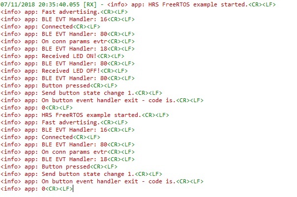

I am trying to run the blinky example together with freertos (nRF52840 pDK, pca10056, segger studio), so I took the hrs_freertos example and added ble_lbs service from blinky example. I also do not use bsp support. Led characteristics works fine, but when I press the button, button event handler is called, but when the code come to "ble_lbs_on_button_change" I get "unknown function at /some address/") - in case of runing sw without debug, processor goes to reset.
If I return from button_event_handler() before the call to "ble_lbs_on_button_change()" program is working normal (except without notifications of course)
Any idea what I am doing wrong?
The main.c is attached.

static void button_event_handler(uint8_t pin_no, uint8_t button_action)
    ret_code_t err_code;
    NRF_LOG_INFO("Button pressed");
//  return;
    switch (pin_no)
        case LEDBUTTON_BUTTON:
            NRF_LOG_INFO("Send button state change 1.");
            err_code = ble_lbs_on_button_change(m_conn_handle, &m_lbs, button_action);
            if (err_code != NRF_SUCCESS &&
                err_code != BLE_ERROR_INVALID_CONN_HANDLE &&
                err_code != NRF_ERROR_INVALID_STATE &&
                err_code != BLE_ERROR_GATTS_SYS_ATTR_MISSING)
        default:
            APP_ERROR_HANDLER(pin_no);

  • I'm not able to reproduce this issue with your code. If notifications is enabled, the error code is SUCCESS. If notifications are not enabled, I get error code 8 (INVALID_STATE) but this error code is ignored.
    Are you doing anything specific to trigger the error?
    I use nRF Blinky App on Android to connect and press button 0 on the board.
    I added some additional NRF LOG outputs and it  can be seen
    NRF LOG shows:
    As it can be seen from this log, the device restarts after return from button event handler - it goes to HardFault_process.
    In debug mode the Output is: "Stopped by vector catch"

  • This is the output I get from the log when running your example (switched between notifications enabled and disabled in the middle):

    • Which SDK version are you using?
    • Which nRF52840 (P)DK version are you using?
    • Which SES version are you using?
    • Which phone/central are you connecting with?
  • SDK 15.0.0. - s140_nrf52_6.0.0_softdevice.hex
    nRF52840 PDK v091 (2017.14)
    SEGGER Embedded Studio for ARM Release 3.40  Build 2018052200.36079 Windows x64
    Samsung GTI-9300 Android 4.3, but it is the same with IPhone 6s.iOS12.01 (the status of led after connection is also wrong on Android and iPhone)
    I will order the latest DK and try with latest SDK.
  • I just got new HW - this time nRF52 DK (pca10040 v1.2.4 2018/38).
    Build the same project with S132 (s132_nrf52_6.0.0_softdevice.hex) and the same problem is still there.
