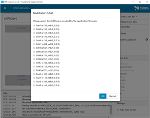

Hello there, I am trying to write hex file generated form Keil or Segger studio but a popup window comes out to select the soft device in nRF connect programmer, I have selected every option but it will fail to write the hex, but if I will upload the hex that are given in hex folder it will upload that one. Does any body know that what exactly is the error? or is there any way to remove that soft device firmware so that it will be able to upload the hex.

also if i select the s140 the following error comes out
Data block: 0x00026000-0x0002B8BC (0x000058BC bytes long)
Hash is generated by SHA256
Performing DFU. This may take a few seconds
DFU procedure starts. This may take a few seconds.
DFU failed: Error message for known extended error code from DFU target: The array of supported SoftDevices for the update does not contain the FWID of the current SoftDevice.
Device not found due to failure during DFU
and it shows that the specified sdReq does not match the current soft device, please select a different value
and it stop writing the hex, does any one help me out in this.
    Are you using the 1.0.0-experimental.5 version of the Programmer app, and did you upload the correct softdevice version (s140 v.6.1.0 if you are building examples from SDK 15.2.0)?
    I tried this with the hrs example and was unable to reproduce the error. This is what I did:
    1. Built the hrs example with Keil
    2. Opened the programmer app and selected the .hex file I built together with the s140 softdevice from  nRF5_SDK_15.2.0_9412b96\components\softdevice\s140
    3. Verified that the dongle was advertising.

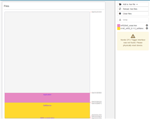

  • You need to include the softdevice .hex in addition to the application .hex in D:\nRF5_SDK_15.2.0_9412b96\nRF5_SDK_15.2.0_9412b96\examples\ble_peripheral\ble_app_blinky\pca10059\s140\arm5_no_packs\_build, see screedump from my previous reply.
    The pre-compiled hex in D:\nRF5_SDK_15.2.0_9412b96\nRF5_SDK_15.2.0_9412b96\examples\ble_peripheral\ble_app_blinky\hex\ contains softdevice+application which is why you don't have to include the softdevice.
