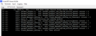

Loop in flash_manager_wait function() Mesh SDK 2.2.0, Light Switch Proxy Server Example
Hello, i am having problems with a loop in the function "flash_manager_wait()"; in the begining of the code.
main()-> initialize()-> mesh_init()-> mesh_stack_init(&init_params, &m_device_provisioned))-> dsm_flash_config_load()-> (void) dsm_flash_config_load()-> flash_manager_wait();

this happen after many reboots thath i do each 1 minute, and the only form to recover it, is erase all the flash, and re flashing soft-device and program.
i do the reboot whit the timer1 and the " function mesh_stack_device_reset()"

    Is there a particular reason you have the nrf_delay_ms(100) in your timeout handler? It probably isn't that scary to use in mesh, but it may caused some unexpected behavior when you also use the "normal" BLE stack (proxy-example). At least if the softdevice is still running.
    I suspect that what might have happened is that the device is reset due to a softdevice assert, and not due to mesh_stack_device_reset(); at one point in time, and it was reset with an unstable flash, since the chip is halted for 100ms, which may crash with some softdevice event. When it returns, and is about to continue with the mesh_stack_device_reset, it may have been interrupted by a softdevice assert before having the time to do this.
    Can you try to remove the nrf_delay_ms() (also if you use them any other places).
    If that doesn't help, can you check which of the checks inside flash_manager_is_stable() that returns false?
    return (!packet_buffer_can_pop(&m_action_queue) && !flash_manager_defrag_is_running());
    Either packet_buffer_can_pop(&m_action_queue) returns true, or flash_manager_defrag_is_running() returns true.
    If you are still stuck after this, is it possible to send a project and some instructions on how I can replicate this?
    Edvin
  • Can you try to remove the nrf_delay_ms() (also if you use them any other places).
    i tried this, but happen the same.
    (!packet_buffer_can_pop(&m_action_queue) && !flash_manager_defrag_is_running()); = 0
    i am using nrf52 DK, and Mesh Sdk 2.2.0 whit softdevice 6.0.0, the light_switch_proxy_server_nrf52832_xxAA_s132_6_0_0
    just changue the main file, program the board, init Jlink rtt viewer and wait. until the board stop.

        softdevice_irq_priority_checker();
        uint32_t ram_start = 0;
        /* Set the default configuration (as defined through sdk_config.h). */
        err_code = nrf_sdh_ble_default_cfg_set(MESH_SOFTDEVICE_CONN_CFG_TAG, &ram_start);
        gap_params_init();
        conn_params_init();
        mesh_init();
    static void start(void)
        rtt_input_enable(app_rtt_input_handler, RTT_INPUT_POLL_PERIOD_MS);
        ERROR_CHECK(mesh_stack_start());
        if (!m_device_provisioned)
            static const uint8_t static_auth_data[NRF_MESH_KEY_SIZE] = STATIC_AUTH_DATA;
            mesh_provisionee_start_params_t prov_start_params =
                .p_static_data    = static_auth_data,
                .prov_complete_cb = provisioning_complete_cb,
                .p_device_uri = NULL
            ERROR_CHECK(mesh_provisionee_prov_start(&prov_start_params));
        const uint8_t *p_uuid = nrf_mesh_configure_device_uuid_get();
        __LOG_XB(LOG_SRC_APP, LOG_LEVEL_INFO, "Device UUID ", p_uuid, NRF_MESH_UUID_SIZE);
        initialize();
        execution_start(start);
         config_TIMER ();
         TIMER_REINICIO2 = 1;
         NRF_TIMER1->TASKS_START = 1;
        for (;;)
            (void)sd_app_evt_wait();
    i hope you can help me.
    thanks
  • i set the Timer to 3 seconds for speed up the process.
  • Hello, i want to know if you are working on this, or do you have some actualization ?
    Thanks.
  • Hello, Yes. I am looking into this. I still haven't found the reason for why it is stuck in the while loop. I will let you know as soon as I know.
    BR,
    Edvin
