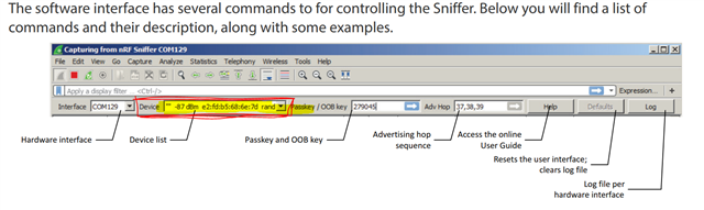

I am using nRF-Sniffer-v2.0.0.2 beta as seen here: https://www.nordicsemi.com/eng/nordic/Products/nRF-Sniffer/nRF-Sniffer-v2/65225 on a nRF52840 DK.
Wireshark Version: 2.4.6

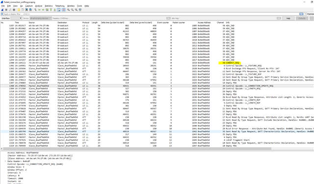

In short, after completing every troubleshooting step in the nRF_Sniffer_Users_Guide_v2.2, I am able to log and view advertising packets from my peripheral BLE device but cannot view packets after a connection has been established. I am connecting to my peripheral using nRF Connect on my Andoid phone. As soon as I connect, I no longer see any transmissions. From what I have read online, this is because Wireshark was not able to follow the complete connection process due to packet loss with seems to be the case according to the log below (Packet read timed out.).

I am a a loss as to what else to try. I need some way of sniffing packets that use DLE and large packet sizes. If the nRF51 devices can do this (which I don't think they can), I am willing to switch to other hardware or older software to get around this issue. See the log below and attached Wireshark log. Also note that once the connection is established, the peripheral is constantly pushing large packets of ~200 bytes to the client. This is seen on the nRF Connect Android app so I know packets are being sent. Besides, I would at least expect to see a bunch of empty PDU's. Also note that Notifications were enabled when these logs were captured.
nRF log reported in Wireshark:

Failed_connection_sniffing.pcapng
