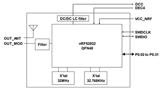

  • This is the correct datasheet for the EYSHCNZWZ. The block diagram (below) shows a LFXTAL of 32.768KHz.
    I can't seem to find any detail on this XTALs and the accuracy. Can I assume it is just as good as the one on the DK and use those same settings?
    Sorry. You are correct. I found the datasheet to the EYSHSNZWZ, not EYSHCNZWZ
    I can't find any information on the LFXTAL in that datasheet either. You can check with the vendor or producer of the module. They should know.
    I found a hint, though. On page 9 in the datasheet that you sent, there is a section regarding ANT:
    " *2 ANT specification requires +/-50ppm accuracy for 32.768kHz clock. the internal 32.768kHz crystal does not meet to +/-50ppm over the whole recommended operation temperature range. "
    So it probably means that the XTAL is in the field around 50ppm, but not below that value for all temperatures. It is probably not 20ppm, which is the default setting in the SDK examples. Try to just increase (/decrease) the accuracy from 20ppm to 50ppm or 75ppm in sdk_config.h.
