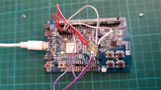

EDIT:
I attach a picture of the setup, just in case there is something wrong here:

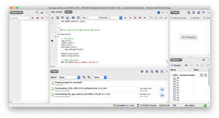

And this is how my screen looks after clicking Debug > Go
As you can see, it doesn't seem to be debugging, even if the output says that everything is OK. Breakpoint is never reached. The "CortexM4 on J-Link" green indicator is blinking
