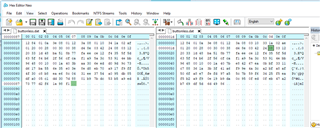

    The manifest.json file doesn't tell you this information anymore. However, you can retrieve all the information from the .dat file in the DFU image.
    Below is a comparison of two dat files created with the same .hex file, but different settings. The one to the left is generated with:
    nrfutil pkg generate --application buttonless.hex --application-version 1 --hw-version 52 --sd-req 0xAF --key-file keys\private.key test_dfu_pkg.zip
    And the one to the right is generated with:
    nrfutil pkg generate --application buttonless.hex --application-version 3 --hw-version 51 --sd-req 0xAE --key-file keys\private.key test_dfu_pkg.zip

    As you can see, the 10th byte changes from 01 to 03, so this is the application version.
    The 12th byte changes from 34 to 33, so this is the --hw-version (0x34 = 52, 0x33 = 51)
    The 15th byte changes from af to ae, so this is the --sd-req.
    You can do these experiments to check where the different fields are stored.
    Alternatively, you can look at the source code for nrfutil, which you can find here.
    As mentioned in one of the links you provided, you can use nrfutil pkg display <dfu_img path> to display all the information from a computer. See if you can find out where and how in the nrfutil source code this is done.
