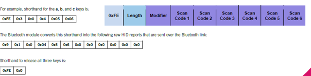

Recently, I was trying to use the hid sample to development specific application.
I just view there was the report map inside the reference file.
I am curious about how can I use the below concept into the project? Especially the shorthand mode.
Frankly speaking, I am not clear about where is the structure used in the sample code.
  • Hi Kenneth,
    I actually want to  change the report map thus I would like to know where can I see the structure in the code if I want to use the shorthand mode.
    From the map in sample code below, I couldn't find where should I put 0xFE.

    And I would like to make sure it is possible to use the command below:
    send[6]={0xFE,0x3,0x00,0x4,0x5,0x06}
    Is it can be used and work in the code which means the library can identify it automatically?
