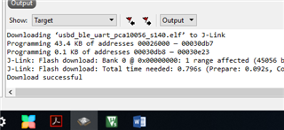

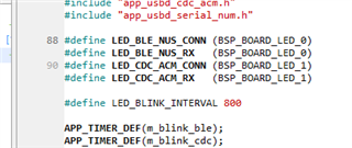

    I still failed. I found in the specific details of the USBD BLE UART Example that I need to use the nRF UART application when I want to send data. I would like to ask where this application can be found. And I have a Jlink, so I can program Dongle, I downloaded Softdevice and downloaded the USBD BLE UART, but my LED light still didn't respond. (However,Softdevice,I use the Keil5,and the program,I use the SES,it’s OK?)I found this example to be only PCA10056, not 10059, so I tried to rewrite the previous definition, i change the number of LED,0,1,2,3 become 0,0,1,1,but it still didn't respond after completion. Where is my problem?

  • VDD must be >3V for the LEDs to work properly. The following code change will ensure that UICR.REGOUT0 gets set:
    diff --git a/examples/peripheral/usbd_ble_uart/main.c b/examples/peripheral/usbd_ble_uart/main.c
    index 57396f2..91018f1 100644
    --- a/examples/peripheral/usbd_ble_uart/main.c
    +++ b/examples/peripheral/usbd_ble_uart/main.c
    @@ -613,8 +613,10 @@ static void advertising_init(void)
     /** @brief Function for initializing buttons and LEDs. */
     static void buttons_leds_init(void)
    -    uint32_t err_code = bsp_init(BSP_INIT_LEDS, bsp_event_handler);
    +    uint32_t err_code = bsp_init(BSP_INIT_BUTTONS, bsp_event_handler);
    +    bsp_board_init(BSP_INIT_LEDS); // Sets UICR.REGOUT to 3V
    Also, to get the correct pinout, replace the BOARD_PCA10056 flag with BOARD_PCA10059 before you build. You can use Keil, SES or GCC.
