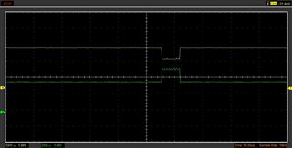

I am a beginner on NRF52840. I am using Nrfx_spim example for interfacing sensor with NRF Board.
I have done some driver about Reg_read and Reg_write. I tried to read the device ID of the sensor through SPI yielding improper results.
Hence I probed on the SPI_SCK line and I found that the duty cycle of SPI_SCK is not proper and also set up and hold times are not proper.

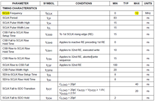

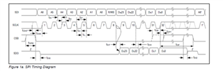

In my requirement timing of the SPI should be as in the attached image below.
To be more specific I need to meet the timing requirements as of detailed in the image below.

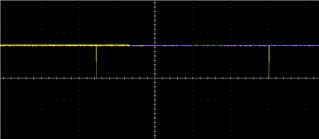

Presently The waveform what I am observing on probing SPI_SCK is as below.
I am pretty sure that my SPI configurations are not proper, please provide me a pointer where I can do the SPI configurations to meet the timing requirements detailed above.
Expecting your kind help.

    I assume you have used the SDK example as reference: \nRF5_SDK_15.2.0_9412b96\examples\peripheral\spi
    (http://infocenter.nordicsemi.com/topic/com.nordic.infocenter.sdk5.v15.2.0/hardware_driver_spi_master.html?cp=4_0_0_2_0_13
    The timing you refer are okey, these are just min and max values, and should fall well within the timing of the spi master of the nRF52. For instance it says the clock frequency should be between 0 and 12MHz, which means you can for instance use 1MHz clock rate.
    I think you should zoom into your plot, I suspect you have an SPI transfer every 250ms(? timing not shown) here.

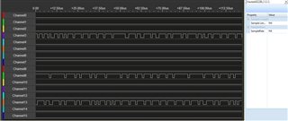

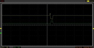

    2) If I Read 0x0F register then I Got below waveform and data in RX Buffer.
    Probing: MOSI For Yellow and Blue for SCK Pin
    3) but Even without calling the Reg_Read function into the main function then also data is coming in to RX Buffer.

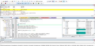

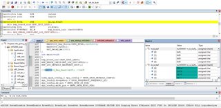

    Thanks for my driver recovery. I have changed the code as per your suggestion. And Its work fine.
    I get data in TX and RX buffer.
    But I am not getting correct waveform please check my SPI configuration.
    but I am getting below waveform it is totally wrong. I am not sure about my SPI Configuration so please check it.
    MISO Channel 3 , CS channel 7, SCK Channel  9 and Channel  13 MOSI.

    spi_config.mode = NRF_SPIM_MODE_0; // SCK active high, sample on leading edge of clock, CPOL=0/CPHA=0
    spi_config.bit_order=NRF_SPIM_BIT_ORDER_LSB_FIRST;
    //nrfx_spim_xfer_desc_t xfer_desc=NRFX_SPIM_XFER_TRX(m_tx_buf, sizeof(m_tx_buf), m_rx_buf, sizeof(m_tx_buf));
    APP_ERROR_CHECK(nrfx_spim_init(&spi, &spi_config, spim_event_handler, NULL));
    	NRF_LOG_INFO("NRFX SPIM example started.");
    while (1)
    // Reset rx buffer and transfer done flag
    memset(m_rx_buf, 0, m_length);
    spi_xfer_done = false;
    MAX30003_Reg_Read(INFO); //0x0F
    APP_ERROR_CHECK(nrfx_spim_xfer_dcx(&spi, &xfer_desc, 0, 15));
    while (!spi_xfer_done)
    __WFE();
    NRF_LOG_FLUSH();
    bsp_board_led_invert(BSP_BOARD_LED_0);
    nrf_delay_ms(200);

  • Looks like you are sampling the SPI with too slow sampling rate setting, then you get strange waveform. You need to reduce SPI speed or increase sample rate (preferred).
    Kenneth
