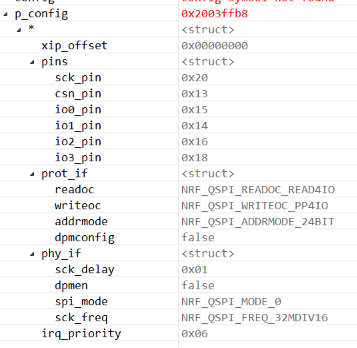

    Are you using an nRF52840 DK? Have you studied the Connector interface and checked whether the pins you are using are not already used for something else? Note also that the pins used for the memory chip on the DK is not routed to the connectors along the edge. If you want the pins connected to the connectors you will have to cut and solder some solder bridges
  • Hi
    Thanks for the quick reply. Our hardware team already free up those port and connect it to the new memory chip. The modification is based on PCA10056_schematic_and_pcb.pdf from nordic website.

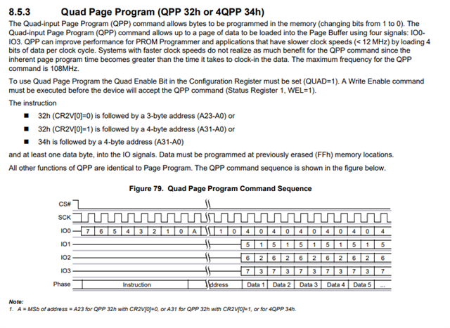

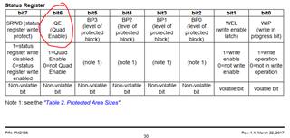

    And we did managed to recapture write output on the pin on SI0,SI1,SI2,SI3,CLK and CS

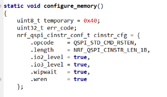

    I suspect there are some address different in pre configure the chip to enter quad mode spi
    Here is some link info about the chip I using now.
    https://community.cypress.com/docs/DOC-15299
    May I know how can I decode the info for .io2_level,io3_level,wipwait,wren. Where can I change the address? And what is the temporary = 0x40 use for?
    what is NRF_QSPI_BASE? Was it part of the QSPI address in the nrf52840 transmit buffer? I notice those nrf_qsi_cinstr_conf_t value were convert into binary and store in the NRF_QSPI_BASE.
    It is the value written to the Status Register in the memory chip on the nRF52840 DK to enable quad SPI (the writer of the example could have chosen a better variable name). From the MX25R6435F datasheet:
    What do you mean by decode? If you wonder what the fields are for then maybe the documentation can help.
    There seems to be some differences between the two memory chips, but it also seems pretty clearly documented in your link:
    1. Initiate the WREN (05h) ....
    2. Initiate the WRR (01h) command; input “02h” (for SR1NV[1]); input “02h” (for CR1NV[1]); input “68h” (for CR2NV[3]) .....

    static void configure_memory()
        uint8_t temporary[4] = {0x02,0x02,0x68,0x78};
        uint32_t err_code;
        nrf_qspi_cinstr_conf_t cinstr_cfg = {
            .opcode    = QSPI_STD_CMD_RSTEN,
            .length    = NRF_QSPI_CINSTR_LEN_1B,
            .io2_level = true,
            .io3_level = true,
            .wipwait   = true,
            .wren      = true
        // Send reset enable
        err_code = nrf_drv_qspi_cinstr_xfer(&cinstr_cfg, NULL, NULL);
        // Send reset command
        cinstr_cfg.opcode = QSPI_STD_CMD_RST;
        // Send WREN
        cinstr_cfg.opcode = 0x06;
        // Switch to qspi mode
        cinstr_cfg.opcode = QSPI_STD_CMD_WRR;
        cinstr_cfg.length = NRF_QSPI_CINSTR_LEN_5B;
        err_code = nrf_drv_qspi_cinstr_xfer(&cinstr_cfg, &temporary, NULL);

    Under nrfx_qspi.h, do we need to modify the value for READOC and WRITEOC?
    #define NRFX_QSPI_DEFAULT_CONFIG                                        \
        .xip_offset  = NRFX_QSPI_CONFIG_XIP_OFFSET,                         \
        .pins = {                                                           \
           .sck_pin     = NRFX_QSPI_PIN_SCK,                                \
           .csn_pin     = NRFX_QSPI_PIN_CSN,                                \
           .io0_pin     = NRFX_QSPI_PIN_IO0,                                \
           .io1_pin     = NRFX_QSPI_PIN_IO1,                                \
           .io2_pin     = NRFX_QSPI_PIN_IO2,                                \
           .io3_pin     = NRFX_QSPI_PIN_IO3,                                \
        .irq_priority   = (uint8_t)NRFX_QSPI_CONFIG_IRQ_PRIORITY,           \
        .prot_if = {                                                        \
            .readoc     = (nrf_qspi_readoc_t)NRFX_QSPI_CONFIG_READOC,       \
            .writeoc    = (nrf_qspi_writeoc_t)NRFX_QSPI_CONFIG_WRITEOC,     \
            .addrmode   = (nrf_qspi_addrmode_t)NRFX_QSPI_CONFIG_ADDRMODE,   \
            .dpmconfig  = false,                                            \
        .phy_if = {                                                         \
            .sck_freq   = (nrf_qspi_frequency_t)NRFX_QSPI_CONFIG_FREQUENCY, \
            .sck_delay  = (uint8_t)NRFX_QSPI_CONFIG_SCK_DELAY,              \
            .spi_mode   = (nrf_qspi_spi_mode_t)NRFX_QSPI_CONFIG_MODE,       \
            .dpmen      = false                                             \
    Under nrf52840_bitfields.h there are WREN and WIPWAIT which the nordic help page didn't not disclose much, do I need to modify those value based on the following table

    I would like to learn to understand and how to configure prot_if parameters.
    readoc structure
    1) NRF_QSPI_READOC_READ4IO = 0xEB which is Quad I/O Read which is same as S25F064L Quad I/O Read 0xEB?
    2)  NRF_QSPI_WRITEOC_PP4IO = 0x38 for MX25R6435F chip its 4PP? Was it the same as S25F064L 4QPP which is 0x34?
    If I want to change those value, where can I change it? I just don't understand the code in nrf52840_bitfields.h, and how can I change if the PP4IO instruction if its different?
    /* Bits 5..3 : Configure number of data lines and opcode used for writing. */
    #define QSPI_IFCONFIG0_WRITEOC_Pos (3UL) /*!< Position of WRITEOC field. */
    #define QSPI_IFCONFIG0_WRITEOC_Msk (0x7UL << QSPI_IFCONFIG0_WRITEOC_Pos) /*!< Bit mask of WRITEOC field. */
    #define QSPI_IFCONFIG0_WRITEOC_PP (0UL) /*!< Single data line SPI. PP (opcode 0x02). */
    #define QSPI_IFCONFIG0_WRITEOC_PP2O (1UL) /*!< Dual data line SPI. PP2O (opcode 0xA2). */
    #define QSPI_IFCONFIG0_WRITEOC_PP4O (2UL) /*!< Quad data line SPI. PP4O (opcode 0x32). */
    #define QSPI_IFCONFIG0_WRITEOC_PP4IO (3UL) /*!< Quad data line SPI. PP4IO (opcode 0x38). */
    3) The S25F064L chip come in SPI as default setting, is the on board PCA10056 DK MX25R6435F already preconfigured with QSPI setting? If yes, How can I the command in SPI using QSPI resource?
    4) is the default QSPI sample setting same for operation below?
    http://www.cypress.com/file/316661/download
