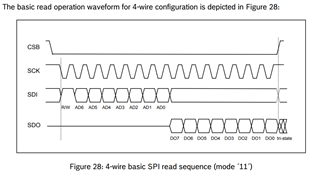

For generate 16 clock cycles, i need to write extra 0x00 bytes in msp430.
TX and RX operations works simultaneously like MSP430?
Read diagram should be like below.

  • Hi
    Slave device BMX055 IMU. The problem looks like pcb trace or SPI peripheral registers related.
    MISO from device
    There is a strange voltage on MISO line. I'm sure MOSI is correct.
    It should be byte1: 0x00 byte2:11111010
    but byte2:????1?1?, there are uncertain values.
    I didn't set SPI pins input or output,only set ChipSelect as output.
    What is the problem? Is it pcb trace related or what?
    Best Regards
  • BMX055 has 3 sensors inside. Acceleremoter,Gyro,Magnetometer. There are 3 different Chip Select.
    My mistake, Gyro CS was LOW!.(This means both ACC and GYRO was active)
    Expected response for ACC:     1111 1010
    Expected response for GYRO:  0000 1111
    Result on MISO                         ???? 1?1?
    If 2 sensors drive different bit values at the same, data collision occured and this results avarage value on MISO line.
