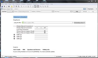

3) WireShark Main Window see attached file
I am using WireShark v2.6.5. Is it OK?
Yes, that is OK.

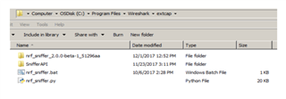

Have you unzip'ed the ZIP's extcap content to the Wireshark Extcap folder, so it looks like this?

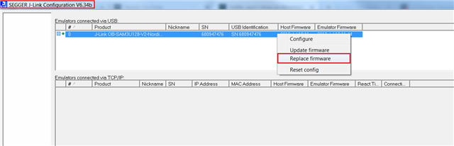

Please make sure that the dongle is actually using the Segger V6.34b firmware. Start JLinkConfig.exe , for me this is located in the folder C:\Program Files (x86)\SEGGER\JLink_V634b. Then replace the FW like this:

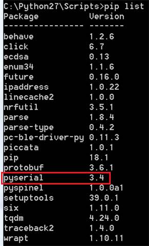

Also check that the pyserial 3.4 for Python 2.7.x is installed:
