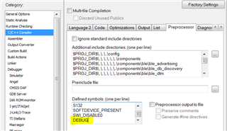

    Could you set the DEBUG preprocessor flag:

  • We do not have the debug UART enabled. I will look at the Debug Processor flag.
    Even if the debug UART is enabled I do not suppose we could see anything when the processor resets.
     That is the reason why we add the DEBUG Processor flag, it will prevent the reset, and should instead print the error-code.

  • I agree with you on the DEBUG processor flag. I was just referring to the debug uart and not the flag.

  • If you are entering the APP_ERROR_CHECK() with an error code, and you have DEBUG defined and logging enabled, the app_error_fault_handler() function will print the error code. In “nRF Only mode”, the debugger IC is not powered, but if you have a logic analyzer that can parse the serial data, you can just hook the analyzer up to the UART TX pin(p0.06), and see what the error code is.
