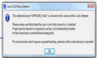

I accidently clicked on Recover button which erase all application firmware. Now my led 1 is not blinking and the nrf52840 device is not detecting in the IAR while debugging THE BLINKY example. How to solve this problem?

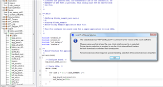

    But i tried the same example in IAR, but the segger Jlink doesnot recognize the NRF52840 DEVICE.

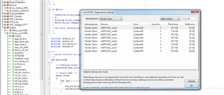

    if i try to find the device it doesnot have nrf52840 and  all other versions on nrf are available.
    If i tried with nrf52832 it was worked and all led are blinked like in nrf52840.
    How can i add nrf52840 into the segger jlink device list?
