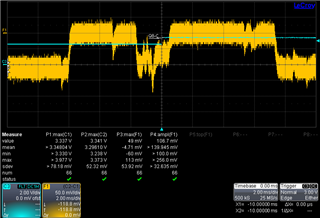

Here attached one plot I got, can someone tell me if it looks reasonable or not? Thanks in advance
  • I am afraid that we do not have any online power profiler for Bluetooth Mesh node.
    A Bluetooth Mesh device will sent packets like a regular Bluetooth Low Energy device, i.e. on 3 separate channels back to back. However, as opposed to regular Bluetooth Low Energy devices, a Bluetooth Mesh node will usually keep the Radio in RX mode the majority of the time. So, if you plot the current consumption you will have a constant current draw corresponding to the NRF52840's Radio RX current.
    I cant see any current numbers in the attached plot.
    Best regards
    Bjørn

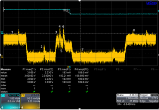

    I actually redid the test last week, I'm using nRF52840, with DCDC off. Here's the plot and data I got. I noticed that when I probe the server board using the light_switch mesh example, I only had one Tx-Rx cycle (instead of 3 as you mentioned). Not sure what's the reason for that. Could you take a look at the graph and the data, and please let me know if I'm doing anything wrong? Thank you thank you.
    State
    Time[ms]
    Current[mA]
    1
    Always radio on
    12
    2
    Pre-processing and Standby
    4
    4
    3
    Radio preparation
    0.6
    10
    4
    TX
    0.4
    15
    5
    TX to RX transition
    0.6
    10
    6
    RX
    0.2
    14
    7
    Post-processing and Standby
    7
    0
    8
    Always radio on
    12
