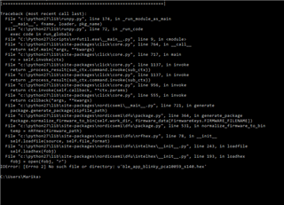

  • now trying with python 2 it game me un other error:
    TypeError: unsupported operand type(s) for +=: 'map' and 'set'
    so..now??? thanks a lot really for your answer!!!!!!!
  • I will correct myself from the last post, as I didn't specify which version of the 2.x series to use, it should be Python 2.7. Then, if you install nrfutil using "pip install nrfutil", you should be able to run the command.

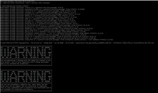

  • now it works like this..an other error:
    but..now??? i have no idea how to overcame this.
  • So... I wasn't able to program the dongle by command line.. But I discovered one problem yesterday about the reset button. After this the dongle returned in bootloader mood and now I can program it by the Nrf connect app. Anyway..  For what reason the command line gave me the same error even if the dongle is now in bootloader mood?
