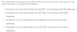

  • Hi Siva,
    If you take a look at the documentation, you see that button 3 turns on LED1 of the servers with the even addresses. You were turning LED1 on/off with the servers that had ODD addresses (i.e. when you provision via the provisioner example).
    Bjørn
  • From the Logs
    i  am getting acknowledgement success when i pressed  Button 0, Button 1.  I am able to Toggle  LED 1 on  one server( i.e Odd server as mentioned in the documentation ).
    I should  get acknowledgement when i pressed  Button2,Button 3. I am unable to toggle the LED on other board(i.e Even Server)

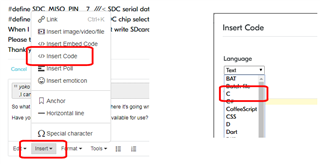

  • Are you sure that the even server has been provisioned & configured correctly? Could you please upload the log from the provisioner board & the two server boards too please? It is easiest to read if you insert them as code (i.e. Insert -> Code):
