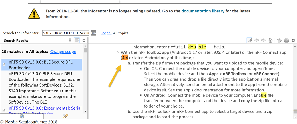

    One last question. From this Infocenter Nordics documentation:
    mobile Connect app v4.4
    it looks as if you could make mobile Secure DFU not only from nRF Toolbox app, but also from mobile Connect app (Android version 4.4 or later). Mine is v4.22.2 but I can't see where the DFU feature is allocated. Would you clarify it?
    Thanks again and,
    Best regards
    Juan
  • Hi Juan,
    The DFU feature only appear when you have the DFU service in your attribute table. It will appear as a button like this:

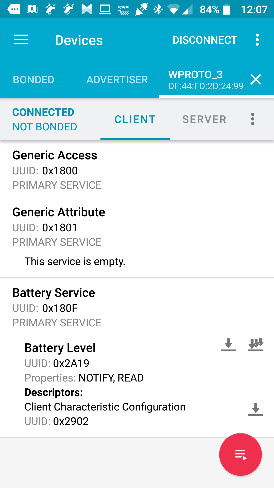

  • heHi Hung.
    I am sure you are right but in my case, I just performed a secure DFU procedure using the nRF Toolbox app from my mobile to program an application in the nRF52840 of my PCA10056 through BLE (whose SD and Bootloader were previously programmed through the virtual COM port). As the procedure was successful, I assume that the target device supports DFU service. Then, scanning the device (the one with a DEVICE_NAME WPROTO_3) from my mobile Connect app, no DFU feature appears in the attribute table:

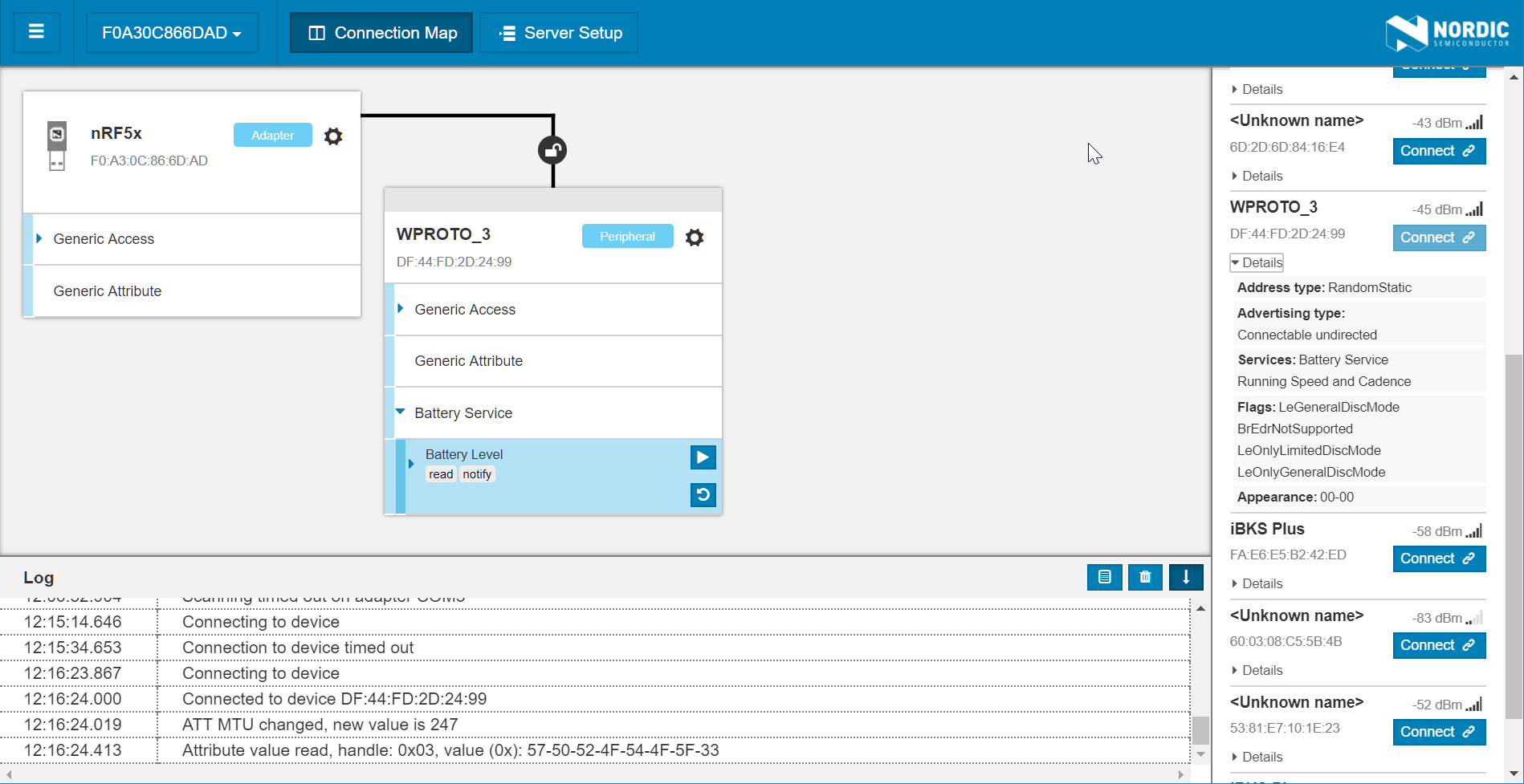

    If I instead scan from mi nRF52840 Dongle using Connect for PC app, that's what I get:
    Also with no DFU feature showing.

  • Hi Juan,
    Which app did you do DFU update on ?
    It seems that the app doesn't support DFU service. I'm not sure why you assume that the app should support DFU.
    Please try to follow this to test the DFU buttonless app . If you want to do DFU update from your app, you need to include the DFU buttonless service (otherwise the only way to go back to DFU mode is to press and hold a button when resetting )

  • Hi Juan,
    Yes on the first time when the bootloader see no application it will by default enter bootloader mode. But when you have your app running, you need to enter the bootloader mode, either by holding a button when booting, or by using DFU buttonless service to receive a command in BLE.
    You can find the DFU buttonless example in \examples\ble_peripheral\ble_app_buttonless_dfu and can find the documentation here.
