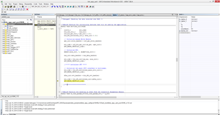

I did the secure bootloader DFU. I attained step 8 in document.
I instal softdevice and secure bootloader to flash nRF52832. After make the ble_app_buttonless_dfu start download and debug but program not start.
If install only softdevice and buttonless_dfu then I got error "No bootloader was found".
If install softdevice and bootloader after buttonless dfu then I got not start programs.
Although security bootloader work.
The verification was performed in the following steps:
E1. Generate new firmware.
E2. Generate new DFU .zip package.
E3. Switch the device to DFU mode, do DFU update and verify new image is running.
Help me.

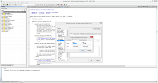

  • I made the following:
    Step A. Generating keys.
    Step B. Build the bootloader.
    B1. Compile the uECC library.
    I download the library to the SDK folder.
    I  start building uECC.
    Copy the public_key in IAR.
    Step C.
    generate bootloader setting.
    mergehex
    zip file
    watch the video here
    What do I do wrong?

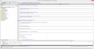

  • I got an error again.
    What do I do wrong?
    bootloader uploaded
  • How do start work DFU? I use function ble_dfu_buttonless_bootloader_start_finalize(); but she not started DFU.

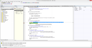

  • I get error.
    Function sd_ble_gap_sec_params_reply(m_conn_handle, BLE_GAP_SEC_STATUS_PAIRING_NOT_SUPP, NULL, NULL) return error 8.
    Error code 8 meant invalid state. I'm not sure why you received that error.
    Have you tried to test with the ble_app_buttonless with no modification ? Have you got an overview of how it work ?
  • Hi.
    Yes I have overview of how it work. See video.
    I got error in function:
        uint32_t err_code;
            case BLE_GAP_EVT_CONNECTED:
                NRF_LOG_INFO("Connected");
                NRF_LOG_INFO("Disconnected");
                ble_gap_phys_t const phys =
                    .rx_phys = BLE_GAP_PHY_AUTO,
                    .tx_phys = BLE_GAP_PHY_AUTO,
            } break;
                // Pairing not supported
            case BLE_GATTC_EVT_TIMEOUT:
            case BLE_GATTS_EVT_TIMEOUT:
            default:
                // No implementation needed.
    In line
    It may be error in ROM?
