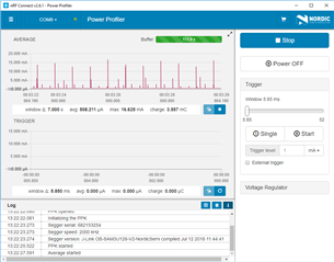

I have programmed an nRF52-DK with the unmodified SDK's ble_app_hrs_pca10040_s132 (heart rate monitor) BLE peripheral application.  I also have a Power Profiling Kit to measure the current.  I have cut SB9 as directed so that the PPK can measure the current, and have the DUT, Power Select, and COM switches all set to "DK" position.
I ran nRF Connect for Desktop, and have installed the Power Profiler application.  The nRF52-DK is connected to my PC via USB cable, and I started the Power Profiler.
While the board is advertising (LED1 on nRF52-DK blinking), I'm seeing an average current of around 585 uA, which seems pretty high.  Is this expected/normal, or do I have something set up incorrectly?
After connecting to nRF Toolkit's HRM app on my smartphone, I see the average current change to about 507 uA.  Again, this seems high, and I'd like to know if this is expected, or if I have something set up incorrectly on one of the boards or in the application.
Can someone please confirm that these average currents are as expected for this application?  If so, can you suggest specific steps that might help reduce the average current?

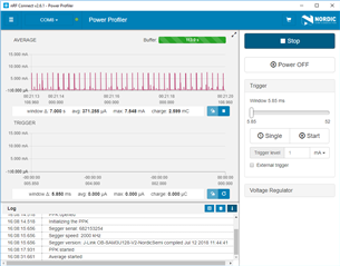

  • Kenneth and DevZone,
    I got some help from my local FAE, and he confirmed that he saw similar current values to what my setup was reporting.
    Further, he indicated that enabling the DC-DC converter could reduce the current consumption by ~40%.  This was accomplished by adding the line:
        sd_power_dcdc_mode_set(NRF_POWER_DCDC_ENABLE);
    right after the call to advertising_start(erase_bonds); in main.c.
    After rebuilding the project in Release mode, reprogramming my nRF52-DK, and reinstalling the PPK, the average current during advertising dropped to about 370 uA.  Much better!  Very grateful for the excellent help on this.
    Some other techniques can evidently be used to reduce power further, including disabling the UART logging, and increasing the advertising interval and connection interval.  I will continue to experiment, but this one call made a huge difference in average current draw.
