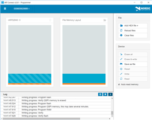

  • when I use the nRF Connect v2.6.1  - Programmer app, it will always be hanged when I flash the s140_nrf52_6.1.0_softdevice.hex.
    Is this indicate that the board flash got a problem?
     hanged at "Write prorgess: verify Flash"

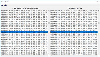

    • Verify the hex file with nRF52840-DK (2) flash memory, found the hex value is not exactly the same
    Thus, can you make a comment on this issue? I would like to ask Element14 to return a new nRF52840-DK if you think this is a hardware flash failure.

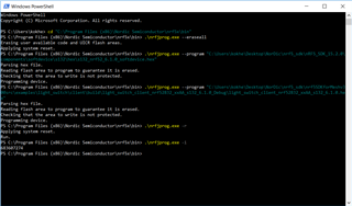

  • Thanks, Bjorn.
    please see the result on below two pictures.
    1) number for bad Board - 683620689
    2) number for good board - 683607274

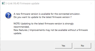

    What you can do is try to flash the interface mcu to the nRF52 DK one more time. Turn off the DK & turn it back on while pressing the IF BOOT/RESET button. You should then see the DK appear as a BOOTLOADER drive. Drag & drop the downloaded Interface MCU FW to the malfunctioning DK. Power cycle the board one more time & try to program by via Segger again.
  • 1) manage to place the bin file (i.e. J-Link OB-SAM3U128-V2-NordicSemi 170724.bin) to the DK.
    2) Power cycle the board again
    3) Program the DK via Segger, but it requires firmware Update
    4) After I press No button, it failed to connect J link.
    5) Thus, I repeat the step from 1 to 3, and then press Yes button to run the J-Link V6.40 Firmware update
    6) After executing the firmware update, it will go to flash the example code into flash and then same flash error come again.
    Please let me know if my step is not correct or bin file download is not the latest version. Thanks
  • You chose the correct interface MCU FW. It was also correct to update the J-Link FW. Could you try an nrfjprog --recover command on the faulty board & then try to program the board again via SES? Does this work?

    2) and yes, both boards are able to program using nrfjprog command but the faulty board didnt pass the flash verification.
    Can I make the conclusion that the faulty board unable to recover by Nordic tools and require to send for hardware inspection by element14?
    When compare flash memory found some hex value is not the same.
  • Yes, I believe we can conclude that this could be a faulty board. Ask element14 to check the HW.
