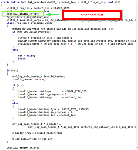

I also encounter a problem, after I pair and bond using  ble_app_hrs_freertos example I just cannot unbond the device (it cannot appear in normal BLE scan, only can detect using Nordic Connect). Please advice how can I unbond the example. And when I tried to call pm_peers_delete( during BLE_GAP_EVT_DISCONNECTED, the device enter NRF_BREAKPOINT_COND.

  • As far as I know, the nordic nrf connect app display as bonded and I cannot scan the advertising from the board in my usual BLE scanning (so I assume its already bonded).
    And yes I tried added APP_ERROR_CHECK to check the pm_peers_delete(), it don't work as it will enter NRF_BREAKPOINT_COND through CRITICAL REGION ENTER just before the function return. I perform the pm_peers_delete() after I disconnected the ble (BLE_GAP_EVT_DISCONNECTED)
  • Did you put a breakpoint at app_error_fault_handler() and debug the code?
