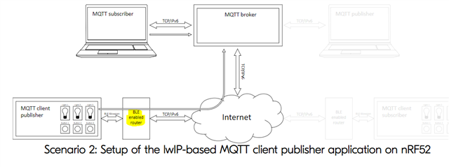

How do I test example project iot mqtt publish and subscribe projects?
The example projects I am referring to is located here:
nRF5_SDK_15.2.0\examples\iot\mqtt\lwip\subscriber\pca10056\s140\ses\iot_lwip_mqtt_subscriber_pca10056_s140
nRF5_SDK_15.2.0\examples\iot\mqtt\lwip\publisher\pca10056\s140\ses\iot_lwip_mqtt_publisher_pca10056_s140
Using a window10 pc:
I have build and downloaded pub program to one nRF52840DK and sub to another nRF52840DK successfully. On my smart phone I can see both of them as Bluetooth devices.
As new to Nordics products and IDE it would be nice with guides/documentation as how to verify that this MQTT pub/sub projects works ( as well as all the other example projects ).
Do I need another Linux board to work as the MQTT broker? Or does the subscriber board also works as a broker?
Appreciate a link to documentation/guides that explain the many example projects.
Thanks
  • Yes, you need a 3rd device that acts as the MQTT Broker, see Setting up the Mosquitto MQTT broker for information on how to set this up on a Windows, Linux or OS X device.
    The MQTT examples are documented here, Experimental: IoT Examples / MQTT. Each example have a Testing subsection in their documentation, explaining step by step how to test the examples, see
    MQTT Client - Publisher / Testing
    MQTT Client - Subscriber / Testing

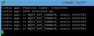

    I am going through the 16 test steps of "pca10056 MQTT Client Publisher"
    https://www.nordicsemi.com/DocLib/Content/SDK_Doc/nRF5_SDK/v15-2-0/iot_sdk_app_mqtt_publisher?1649#iot_sdk_app_mqtt_publisher_test
    And the client startup advertising, push button 1 and it connect to 6lowpan router, push button 2 result in error code 0000c943, instead of connecting to the MQTT Broker.
    What does the error code mean?
    Can you tell me how to insert the brokers IPv6 addr correctly, please!
    Is this correct inserted it in MQTT Client Publisher's main.c file. m_broker_addr
    when:
    linux mosquitto broker's IPv6 addr fe80::8292:9e6f:cc08:1520/64
    windows mosquitto broker's Link-local IPv6: fe80::bdeb:857e:f92b:730f%13
    This is the only place I have setup the MQTT brokers addr, is that correct?

  • Hi Pih
    you need to call
     ifconfig bt0 add 2001:db8::1/64
    to add the prefix, the radvd service does not do this as it shold i thinnk.
    Bjørn
  • "ifconfig bt0 add 2001:db8::1/64" didn't help
    How can I find the root cause of why it's not working?  Is it possible for you to run the example project on the same HW?
