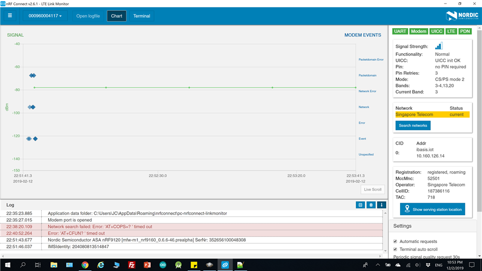

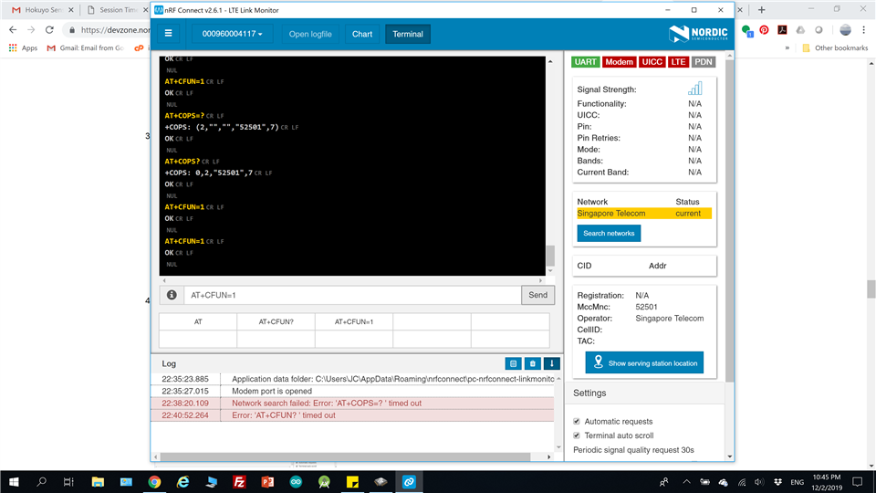

  •  Hi I tried the at_client and LTE Link monitor and it doesn't seem to work.

    2019-02-12T14:35:49.824Z DEBUG modem >> AT+CFUN?\x0D\x0A
    2019-02-12T14:35:49.836Z DEBUG modem << +CFUN: 4\x0D\x0A
    2019-02-12T14:35:49.869Z DEBUG modem << OK\x0D\x0A\x00
    2019-02-12T14:35:49.890Z DEBUG modem >> AT+CFUN=1\x0D\x0A
    2019-02-12T14:35:49.921Z DEBUG modem << OK\x0D\x0A\x00
    2019-02-12T14:37:20.055Z DEBUG modem >> AT+COPS=?\x0D\x0A
    2019-02-12T14:38:20.109Z ERROR Network search failed: Error: 'AT+COPS=?
    ' timed out
  • After a few attempts, I got the modem and other others turned on and connected.
