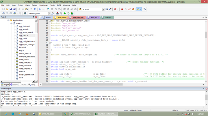

I am able to include all the necessary files,but when i build it shows 2 errors.
I am attaching the picture of error message along with Screenshot of a file in program which appears in faded form.
It's generally better to copy & paste errors as text - rather than a picture.
But your picture is clear enough to see in this case.
Again, this is a standard 'C' issue: header files just contain declarations (function prototypes) - so you also need to add the source (.c) file (or pre-built binary library) with the definitions of those functions.

Have done all the necessary steps in program,also in sdk_config.h.Its not showing any errors now,but when i look on putty nothing appears.If we comment uart portion in main, nrf_log_info statements appear.
