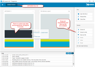

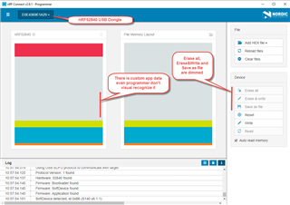

I'm collecting data from BLE and storing them into nRF52840 Dongle by using nrf_fstorage_write procedure. Everything works fine so I can write data into flash by  nrf_fstorage_write and read them by nrf_fstorage_read. Now I'd like to erase all my data stored in Dongle. How can I do it? When I try to use nRF Connect - Programmer button "Erase all" is dimmed.
It works only for nRF dev kit :-(.

    If you erase all flash on your Dongle, you will lose the bootloader and MBR as well, making it useless until you have recovered it as described in this tutorial. You can do a sector erase to to erase the parts that won't "damage" the UICR, but that requires a debugger. The erase button in nRF Connect Programmer will always keep UICR, MBR and the Bootloader, and is whited out when there is nothing else to erase.
    I strongly recommend that you don't erase all on the Dongle, but you can do it by using nrfjprog -e in the command window. If you still want/have to do it, please check out the aforementioned tutorial to make sure you will be able to recover it first.
