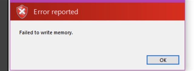

Hello, i recently used a gateway to sensor example and am unable to revert back to factory program of nrf9160 DK.
I toggled the switch 5 to nrf52840 and flashed the first program and then toggled back to nrf9160 and flashed it with the other.
I am trying to revert back by erasing nrf9160 and nrf52840 using programmer from nrf connect app.
I used secure boot for nrf9160 part but what can i use for nrf52840?
Also, what is the placement of  switch 5 by default? Nrf9160 or nrf52840?
I am trying to get back to it’s original state as all worked well with asset tracker previously  but now if i try and program nrf9160, I have a memory location issue.
Thanks!
  •  This is the error i receive when trying to flash asset tracker.

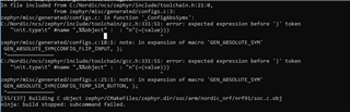

  • Hi Sigurd, I ran those commands and see other issues. See output below. This looks like there may be some issues with the toolchain? I remebered I installed the latest GNU Arm toolchain but had to use a older version because of some issues. Should I need to upgrade?
    Thanks.
