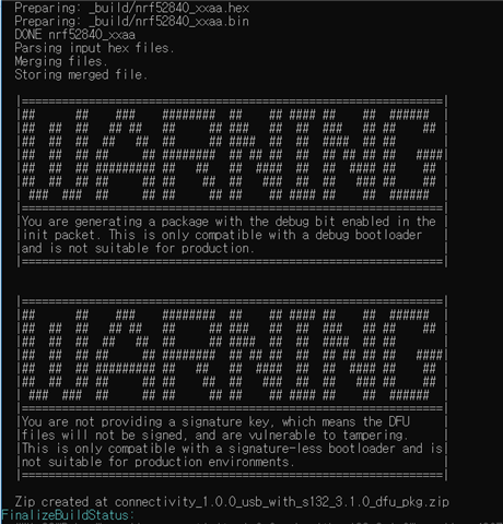

    However, in the building process of connectivity hex files,
    Some projects creating DFU_PKG.zip file generate
    "WARNING"s like the following figure.
    So, I want to get check and confirm about the "WARNING", and also,
    I want to know whether it is normal or abnormal.
    I really appreciate Jorgen Holmefjord's kind guides.
    If you provide some comments about 2), It will be huge help for me.
