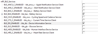

my chip is nrf52810 and softdevices is s112 !
i used sdk is "nRF5_SDK_15.1.0_a8c0c4d ";
i used "ble_app_uart"
the project only uart serives,i want to add dis_services and bat_serives;
but can't found my add services !
i used the ble_app_hrs_freertos in DK <PCA10056> , Also found only one Nordic_HRM service !
but this project already add others services !
I DON'T KOWN WTHAT HAPPEN !
