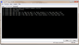

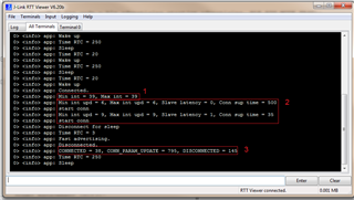

    And a screenshot from the terminal:
    1) The parameters of the minimum and maximum interval of the connection event recorded at the time of contact with the event BLE_GAP_EVT_CONNECTED.
    2) The parameters of the minimum and maximum interval of the connection event recorded at the time of contact with the event BLE_GAP_EVT_CONN_PARAM_UPDATE. Here it is clear that there were 2 hits in this event with different parameters.
    3) Here are the times in ms. The time is shown from the moment the device woke up and hit every event (BLE_GAP_EVT_CONNECTED, BLE_GAP_EVT_CONN_PARAM_UPDATE, BLE_GAP_EVT_DISCONNECTED).

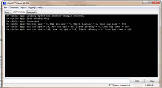

    The parameters of the minimum and maximum interval, which I set:
    #define MIN_CONN_INTERVAL   MSEC_TO_UNITS(11.25, UNIT_1_25_MS)
    #define MAX_CONN_INTERVAL   MSEC_TO_UNITS(12, UNIT_1_25_MS)
    #define SLAVE_LATENCY       1
    #define CONN_SUP_TIMEOUT    MSEC_TO_UNITS(350, UNIT_10_MS)
    I also decided to check on the source code of the example, which I took as a basis. The results are similar, just a few occurrences.
    1 option:
    #define MIN_CONN_INTERVAL               MSEC_TO_UNITS(500, UNIT_1_25_MS)
    #define MAX_CONN_INTERVAL               MSEC_TO_UNITS(1000, UNIT_1_25_MS)
    #define SLAVE_LATENCY                   0
    #define CONN_SUP_TIMEOUT                MSEC_TO_UNITS(4000, UNIT_10_MS)
    2 option:
    #define MIN_CONN_INTERVAL               MSEC_TO_UNITS(48.75, UNIT_1_25_MS)
