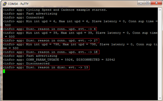

    I also want to clarify that the transfer of useful data itself does not lead to this error. As I showed in the ble_app_cscs example, several connections occur during the establishment of a connection between two devices. After that, you can already freely send and receive data.

    But I want to note that the last example I gave in the last message (screenshot from the terminal) was made on the nRF52832 DK board with a modified ble_app_cscs example, which I also posted. And I checked the operation of the peripheral application using the nRF Connect application.

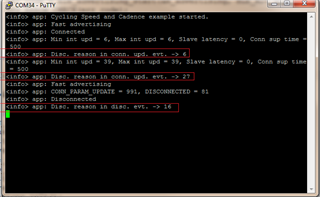

    I checked the reason of the shutdown in the BLE_GAP_EVT_CONN_PARAM_UPDATE and BLE_GAP_EVT_DISCONNECTED events. In the first option, disconnection occurs when I click the "Disconnect" button in the nRF Connect application. In the second option, the disconnection occurs when the second reconnection occurs.
    1 option:
    Reasons:
    0x06 - BLE_HCI_STATUS_CODE_PIN_OR_KEY_MISSING
    0x27 - Requested QoS Not Supported (in file ble_hci.h this definitions commented out)
    0x1E - BLE_HCI_STATUS_CODE_INVALID_LMP_PARAMETERS
    0x13 - BLE_HCI_REMOTE_USER_TERMINATED_CONNECTION
    2 option:
    Reasons:
    0x16 - BLE_HCI_LOCAL_HOST_TERMINATED_CONNECTION
