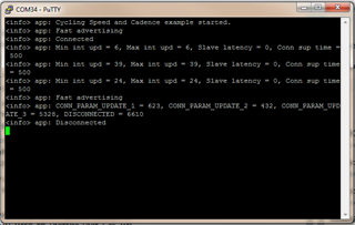

Hi everyone,
I'm new to working with Bluetooth/
My problem is that the connection interval time sent by the central device does not converge with the time I see using an oscilloscope or a configured timer for 1 ms.
The principle of operation of my program is that the peripheral device sleeps for a certain time and wakes up at a specified interval. The central device at this time is trying to connect to it. Using the timer, I count the time from when the device woke up to the time of the BLE_GAP_EVT_CONNECTED event and to the time of the BLE_GAP_EVT_CONN_PARAM_UPDATE event. The time difference between these events is about 600 ms. I can not understand why such a difference in time. Maybe I did not correctly understand the meaning of the parameters MIN_CONN_INTERVAL and MAX_CONN_INTERVAL? If so, then how can you reduce the time for a full connection, so that the BLE_GAP_EVT_CONN_PARAM_UPDATE event occurs as soon as possible.
To check what the actual value is transmitted by the central device, you can make a breakpoint during the execution of the program at the time of the BLE_GAP_EVT_CONN_PARAM_UPDATE event, which I actually did.
According to the received data, the central device set the value of the maximum and minimum interval of 7.5 ms.In the peripheral device, I have the following parameters:
MIN_CONN_INTERVAL    MSEC_TO_UNITS (7.5, UNIT_1_25_MS)
MAX_CONN_INTERVAL   MSEC_TO_UNITS (30, UNIT_1_25_MS)
SLAVE_LATENCY            1
CONN_SUP_TIMEOUT   MSEC_TO_UNITS (250, UNIT_10_MS)
I also read that the connection interval can vary from 7.5 ms to 4 s, maybe this value is the connection interval for my central device?
Chip: BT840F (analog nRF52840);
SDK: nRF5_SDK_15.2.0;
Softdevice: s132_nrf52_6.1.0_softdevice;
Phone: Xiaomi Redmi 5+.
Thanks in advance for your help.

    Sorry for the late reply, but I have finally had time to look at your project. First of all, the reason for the disconnects are because you set your application to disconnect if the connection parameters are above 7.5 ms with this line of code:
    if (max_int_upd > 6)
                                           BLE_HCI_REMOTE_DEV_TERMINATION_DUE_TO_LOW_RESOURCES);
    And I am sorry for confusing you earlier, as I neglected the fact that Android devices have a minimum connection time of at least 15ms (iPhones at 30ms). So you should get rid of this function all together, unless you want it to disconnect every 5 seconds after starting reading.
    It is not the connection event itself that takes time, it seems to be on the central application side. You said your colleague had made an application right. The delay you are experiencing is from the time you connect to the central, until it starts the CSC event. I am guessing that doesn't happen immideately as you connect.
    You should also tune the min_conn_interval and max_conn_interval, as the project you sent me defined these as 500 and 1000, which means that your peripheral wants to use between 500 and 1000 ms to connect. I suggest you set them to the following:
    #define MIN_CONN_INTERVAL MSEC_TO_UNITS(7.5, UNIT_1_25_MS)
    #define MAX_CONN_INTERVAL MSEC_TO_UNITS(30, UNIT_1_25_MS)
    to make it work on both iPhones and Android, as well as removing the function mentioned above that causes disconnects. I hope this was helpful, and if you have any further questions, just ask!

    I used the mentioned function to disconnect after 2 switches. This was done to display the total time spent on establishing a normal connection.
    I removed this function and set the times of the connection connection, as you said. But the number of connections and elapsed time remained the same.
    I slightly changed the connection time measurement for each connection and now it shows how long it takes for each switch.
    I'll post the main.c file so that we can see what has been changed.

    Below is the result with the above changes. The time is in ms.
