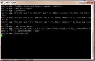

My problem is that the connection interval time sent by the central device does not converge with the time I see using an oscilloscope or a configured timer for 1 ms.
The principle of operation of my program is that the peripheral device sleeps for a certain time and wakes up at a specified interval. The central device at this time is trying to connect to it. Using the timer, I count the time from when the device woke up to the time of the BLE_GAP_EVT_CONNECTED event and to the time of the BLE_GAP_EVT_CONN_PARAM_UPDATE event. The time difference between these events is about 600 ms. I can not understand why such a difference in time. Maybe I did not correctly understand the meaning of the parameters MIN_CONN_INTERVAL and MAX_CONN_INTERVAL? If so, then how can you reduce the time for a full connection, so that the BLE_GAP_EVT_CONN_PARAM_UPDATE event occurs as soon as possible.

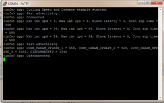

    I'm not sure if this is due to when notifications are enabled. After talking with his colleague, he says that he sends a request for notification as soon as the connection is established. In this case, I see the same delay (~ 800 ms) as your example, where I do not even send a request for notification.
    I also noticed this feature. I also used Xiaomi Redmi Note 6 Pro phones (with Bluetooth module 5.0) and Huawei P Smart (with Bluetooth module 4.2). The delay in applying Huawei is ~ 800 ms. Delay when using Xiaomi (with Bluetooth module 5.0) - ~ 1400 ms. Since the phone with Bluetooth module 5.0 I only have this model and other models don't have, then perhaps this is an isolated case. But if not, then module 5.0 has even more delay, with the fact that data transfer is faster.
    In my project it is very critical that so much time is spent on the connection, since Frequent falling asleep is expected. With such a time there will be a great expenditure of energy. The future device will be battery powered.
    Xiaomi Redmi 5+; project: ble_app_cscs; application on Android: nrf Connect.
    Xiaomi Redmi Note 6 Pro; project: ble_app_cscs; application on Android: nrf Connect.

    I still don't see why you do the connection parameter update (CONN_PARAM_UPDATE), as that is what takes time in your screenshots. This is not a connection event. There are no screenshots in this thread that shows how much time the initial connection takes. They are all just parameter updates. If you comment this out of your code, are you able to show me that the actual connection takes 800ms, because on my end this never takes more than 30 ms or so with another device, and approx. 200ms with my phone (iPhone 6), which seems to be as fast as this example gets with a mobile device.

  • Here I provide my screenshots from nRF Connect.
    It turns out that the connection itself took 308 ms (14: 54: 52: 408 - 14: 54: 52: 710). After this, the connection parameters are updated several times in a row. When the announcement of updating connection parameters appears for the first time (14: 54: 53: 047), the characteristics window is not active, reading, recording, etc. is impossible.
    After the characteristics have been updated for the second time (14: 54: 53: 482), it is possible to read / write from / to the characteristics.
    It turns out that all the time, from the beginning of the connection to the ability to read the characteristics, is 1074 ms (14: 54: 52: 408 - 14: 54: 53: 482).
