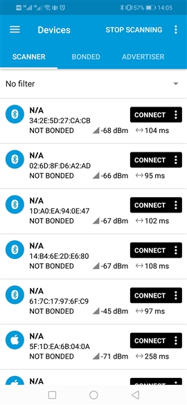

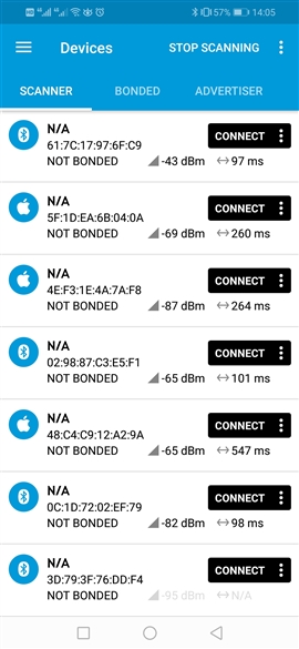

My nRF82832 codes based on nRF5_SDK_15.2.0_9412b96 and used s132_nrf52_6.1.0. But I find the Bluetooth signal of nRF82832 can’t be scanned by smart phone which brands are Huawei and Honor when other brands smart phone can scanned nRF82832 like Xiaomi, OPPO and so on.
I also find another problem. The nRF82832 which I purchased 3 months ago can be scanned by Honor smart phone but Huawei smart phone can’t. But the nRF82832 which I recently I purchased can’t be scanned both Honor and Huawei.

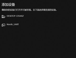

       The following is my test result using nRF Connect app comparing with my PC .

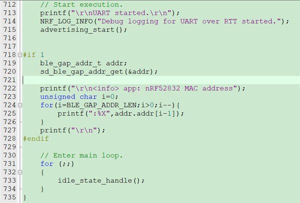

    In order to find problems, I add some codes in the the example " ble_app_uart". The codes as follows:

    In my PCB, I used LFXTAL. Actually I used the example  " ble_app_uart" without any other modification except the "printf MAC address ".
    Besides that all the other components are different brand with the PCB produced 3 month ago.
    Finally from the picture I post before , you can find the Honor smart phone can scan othe bluetooth signal successfully.
