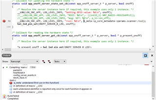

  • Hey thanks Edvin, I am able to find the RSSI of received packet from client when i wrote the code like below mentioned in the function
    static void app_onoff_server_set_cb(const app_onoff_server_t * p_server, bool onoff ) {
    __LOG(LOG_SRC_APP, LOG_LEVEL_INFO, "RSSI: %d\n",- ((int32_t) NRF_RADIO->RSSISAMPLE));
    I am getting an error like this
    'p_data' undeclared
    when i am using this line in the same function.
    __LOG(LOG_SRC_APP, LOG_LEVEL_INFO, "rssi: %d\n", p_meta->p_core_metadata->params.scanner.rssi);
    Thank you
  • Well, the difference between app_onoff_server_state_set_cb() and app_onoff_server_set_cb() is that the first is the function that is called when the server receives a message from a client to turn on of off the lights, while the second is the function that decides which function that is the callback function.
    You need to use app_onoff_server_state_set_cb(), and not app_onoff_server_set_cb().

    You need to use the function app_onoff_server_state_set_cb() in the app_onoff.c file. It looks like this:
    static void generic_onoff_state_set_cb(const generic_onoff_server_t * p_self,
                                           const access_message_rx_meta_t * p_meta,
                                           const generic_onoff_set_params_t * p_in,
                                           const model_transition_t * p_in_transition,
                                           generic_onoff_status_params_t * p_out)
        __LOG(LOG_SRC_APP, LOG_LEVEL_INFO, "msg: SET: %d\n", p_in->on_off);
        app_onoff_server_t   * p_server = PARENT_BY_FIELD_GET(app_onoff_server_t, server, p_self);
        /* Update internal representation of OnOff value, process timing */
        p_server->value_updated = false;
        p_server->state.target_onoff = p_in->on_off;
        if (p_in_transition == NULL)
            p_server->state.delay_ms = 0;
            p_server->state.remaining_time_ms = 0;
        else
            p_server->state.delay_ms = p_in_transition->delay_ms;
            p_server->state.remaining_time_ms = p_in_transition->transition_time_ms;
        onoff_state_value_update(p_server);
        onoff_state_process_timing(p_server);
        /* Prepare response */
        if (p_out != NULL)
            p_out->present_on_off = p_server->state.present_onoff;
            p_out->target_on_off = p_server->state.target_onoff;
            p_out->remaining_time_ms = p_server->state.remaining_time_ms;
    So as you can see, it has a pointer p_meta in the function variables.
