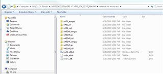

  • I am having some trouble in step B1 Compile the uECC library to build the bootloader. We have been using nrf52 and Segger Embedded Studio for development.
    The picture shows the list of IDE options available in the ..\external\micro-ecc\ folder to compile uECC and I wasn’t able to find my IDE. Any suggestions on how to overcome this would be very helpful.
    This list doe snot necessarily covered all IDEs, but it does cover all supported compilers (for instance Segger Embedded STudio use armgcc). So if you are using a supported toolchain or IDE in the SDK, then you should be covered after successfully running build_all.bat.
