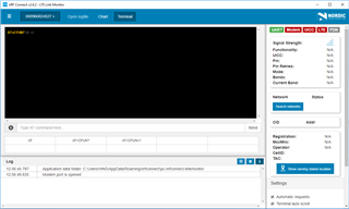

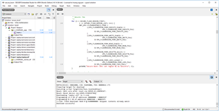

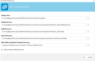

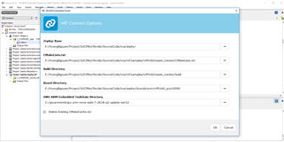

nRF9160 DK: I followed the userguide , devzone.nordicsemi.com/.../getting-started-with-nrf9160-dk
I done with 2 examples: AT Client and Asset Tracker examples. I passed Build and Run. Then, used nRF Connect to check, but nothing came. AT commands didnt work, AssetTracker neither. The led3 and led4 were OFF. Whats wrong?
The LTE didnt ON yet!

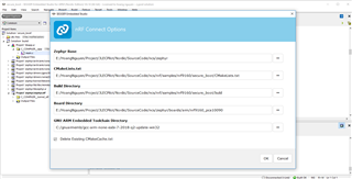

I am using the gcc arm 7-2018 ( i couldnt run with version 8-2018)
Can you tell me why, did I do something wrong?

  • Hi Øyvind,
    I changed to another TALE-SIM of Telia, and programmed SecureBoot and At_Client, and I got respond. I think, the problems came from the iBasic eSIM. I will try to look for GPS/LTE SIM card. and test again

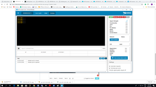

  • Hi Øyvind,

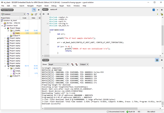

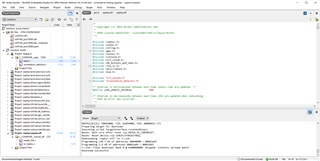

    I tried again step by step to understand more about nrf9160 DK
    1.
    nRF9160: Secure Boot
    Connect nRF9160 DK , turn on and SW5 to nRF91: Build and Run
    Preparing target for download
    Executing script TargetInterface.resetAndStop()
    Reset: Halt core after reset via DEMCR.VC_CORERESET.
    Reset: Reset device via AIRCR.SYSRESETREQ.
    Downloading ‘zephyr.elf’ to J-Link
    Programming 13.3 KB of addresses 00000000 — 0000353f
    Programming 0.1 KB of addresses 00003540 — 000035f3
    J-Link: Flash download: Bank 0 @ 0x00000000: Skipped. Contents already match
    Download successful
    Run: nRF Connect v2.6.2 - LTE Link Monitor , Select device
    2019-03-02T09:46:15.689Z DEBUG modem << Secure Boot: configure peripherals\x0D\x0A

    LED3 and LED4 are OFF
    Is it correct for SecureBoot?
  • I am not able to see the attached images, they are too small.
    Yes, this is correct for the SecureBoot application.
    -Oeyvind
