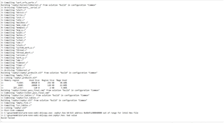

  • Hi, Yes, I have tried all the steps that you suggested above. Please see the attached word document for output from LTE link manager.
    I tried to build the nrf connect sdk project in Segger embedded studio but the build failed. Please see the attached screenshot for reference and kindly help with that as well.

    ase see attached.
  • From this output I can see that your modem FW is outdated. Please download latest FW from this link, under nRF9160 Modem Firmware and Modem DFU Tool. This should fix the connectivity issue.
  • The error message "...out of range for Intel hex file" is connected to the GNU ARM Embedded toolchain. The latest version has a bug which causes this issue. Please download version GNU Arm Embedded Toolchain: 7-2018-q2-update June 27, 2018 instead.
    Unable to read connectivity firmware version: Unable to get version info for 960018772: Error occured when get device info. Errorcode: CouldNotOpenDLL (0x7)
    Lowlevel error: JLINKARM_DLL_NOT_FOUND
    Can you elaborate on what caused this issue? What example did you try to build? There is a similar case here.
