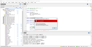

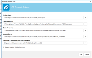

I have nRF9160 DK, and I tried to control SW5 to debug/programme for nRF91 or nRF52.
I could programme for nRF91, but I couldnt do it for nRF52, for example, Im trying with /nrf/samples/bluetooth/central_uart/
and SW5 to nRF52, then Build and Run:
Did I do something wrong? misunderstand somewhere?

    You cannot build/flash bluetooth samples to "nrf9160_pca10090" since it is not a chip that supports BLE.

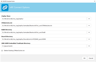

    If you are building for the nrf52840 chip that is on the nrf91DK you need to change the "Board directory" to "nrf52840_pca10090".
    - nrf9160/nrf52840 (decides which chip)
    - pca10090 (is the name of the nrf91 DK)
    A recommended exercise for you to do is to build/flash the LTE Sensor Gateway sample.
    Since there you will need to build/flash one sample to the nrf9160 and one for the nrf52840. (remember to use SW5 to the correct chip you want to program)

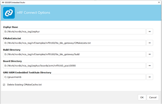

  • Dear Martin,
    I tried to follow the userguide:
    1. Programmed Bluetooth: HCI UART for nRF52: done
    2. Programmed Secure Boot and LTE_BLE_Gateway for nRF91: Done

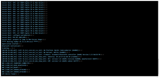

    then run Putty to test:
    Secure Boot: SPU: set SRAM region 12 as Non-Secure
    Secure Boot: SPU: set SRAM region 13 as Non-Secure
    Secure Boot: SPU: set SRAM region 14 as Non-Secure
    Secure Boot: SPU: set SRAM region 15 as Non-Secure
    Secure Boot: SPU: set SRAM region 16 as Non-Secure
    Secure Boot: SPU: set SRAM region 17 as Non-Secure
    Secure Boot: SPU: set SRAM region 18 as Non-Secure
    Secure Boot: SPU: set SRAM region 19 as Non-Secure
    Secure Boot: SPU: set SRAM region 20 as Non-Secure
    Secure Boot: SPU: set SRAM region 21 as Non-Secure
    Secure Boot: SPU: set SRAM region 22 as Non-Secure
    Secure Boot: SPU: set SRAM region 23 as Non-Secure
    Secure Boot: SPU: set SRAM region 24 as Non-Secure
    Secure Boot: SPU: set SRAM region 25 as Non-Secure
    Secure Boot: SPU: set SRAM region 26 as Non-Secure
    Secure Boot: SPU: set SRAM region 27 as Non-Secure
    Secure Boot: SPU: set SRAM region 28 as Non-Secure
    Secure Boot: SPU: set SRAM region 29 as Non-Secure
    Secure Boot: SPU: set SRAM region 30 as Non-Secure
    Secure Boot: SPU: set SRAM region 31 as Non-Secure
    Secure Boot: configure peripherals
    Secure Boot: MSP_NS 2002c898
    Secure Boot: prepare to jump to Non-Secure image
    ***** Booting Zephyr OS v1.13.99-ncs2 *****
    Application started
    Bluetooth init failed (err -19)
    [00:00:28.585,662] <err> bt_hci_core.bt_enable: No HCI driver registered
    How can i fix it ?

  • Hi Hoang,
    Could you confirm that you used these settings when building the samples?
    - SW5 to nrf52
    - hci_uart
    -build and flash for the nrf52
    -SW5 to nrf91
    - Build and flash for nrf91
    Then power cycle the nrf91 DK and check the LTE Link Monitor. (it may take a while to get a link to the basestation the first time)
    - make sure to uncheck the "Automatic requests" to use the LTE Link Monitor as a regular serial terminal:
    I am adding the .hex files as well.
    You can flash these .hex files using the command line:
    nrfjprog --program hci_uart.hex -f nrf52 -r --sectorerase --verifyhci_uart.hex
    nrfjprog --program lte_gateway.hex -f nrf91 -r --sectorerase --verifylte_gateway.hex
