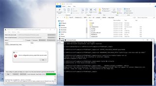

I encountered two problems. My first problem is :
Since I made some changes in Kconfig and gps_sim.c files, I got the following messages when I updated to master branch;  please see lines 1887 to 1890 in the attached file.
error: Your local changes to the following files would be overwritten by checkout:
        lib/gps_sim/Kconfig
        lib/gps_sim/gps_sim.c
Please commit your changes or stash them before you switch branches.
Aborting
After I completed the master branch updates, I lost the ncs/nrf/lib/gps_sim folder completely
Without the gps_sim folder, can I still run asset_tracker and lte_ble_gateway samples?
Did I mess up somethings?  Please advise.
  • I lost the ncs/nrf/lib/gps_sim folder completely
     It has been relocated to github.com/.../gps_sim.

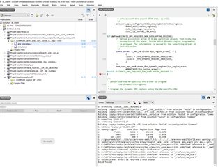

    1) Now I am using the latest master branch to run secure_boot sample and ran into build error
    2) SEGGER complained no Commercial license, but my license will expire on Feb 1 2020.  I have installed it many times, but still no commercial license.

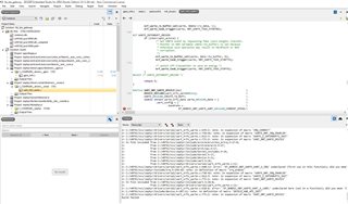

    3) I am using master branch and unable to load asset tracker project

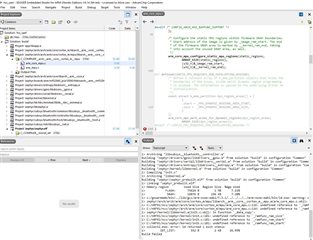

    4) I am using master branch, and at_client Build failed
    5) I am using master branch, same as at_client, hci_uart Build failed.  Please note, I have my license back.

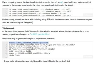

    7) I followed your suggestion to use "set" instead of "export", now I have CMake error.
    Please advise.
  • iotlight said:
    Again I have many more new issues after updated to Master branch.
     SES won't work properly if you are on the master branch. You will probably need to switch to command line tools to build the mqtt_simple sample.
  • Please see item 7) above, I already used command line tools to build mqtt_simple sample and have CMake error.  Please let me know how to fix CMake error.  In additional, I need your guidance on how to successfully build and run this mqtt_simple sample, not just fixing one problem at a time that will take forever to get one sample work.
    P.S. I assumed your command line tools referred to the black window - Command Prompt on item 7) above, otherwise please let me know what is command line tools.
     You need to be in the "build" directory to run the command you are using. ".." is referring to the parent directory "mqtt_simple", which contains CMakeLists.txt.
    To build it, run "Ninja" from the build directory.
    To flash the application to your device, run "nrfjprog --program zephyr.hex -f nrf91 --sectorerase -r --verify" from "mqtt_simple\build\zephyr", or simply "Ninja flash".
