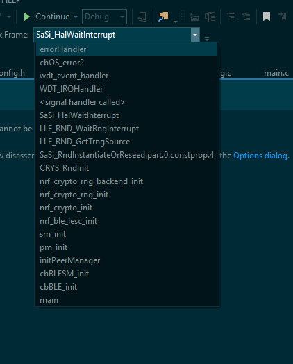

Hi, we stumbled into two issues when we enabled LESC in our application.
Relevant SDK config:
NRF_CRYPTO_ENABLED
NRF_CRYPTO_BACKEND_CC310_ENABLED
NRF_CRYPTO_BACKEND_CC310_RNG_ENABLED
First one is that pm_init() will hang if called when NRF_CRYPTO_BACKEND_CC310_RNG_ENABLED unless we call sd_nvic_critical_region_enter before and then sd_nvic_critical_region_exit after. I can't find anything documentation saying that we need to do that. See attached stacktrace when calling pm_init() without entering critical region. It's the CRYS_RndInit() which hangs and causes the WD to reset.
Second issue I think is related to linking.
I have a theory that the linker does not link cc310_backend_init.o file as the two public functions void cc310_backend_enable(void); and void cc310_backend_disable(void); are
found in cc310_backend_shared.c and therefore CRYPTO_BACKEND_REGISTER does not
place cc310_backend_init and cc310_backend_uninit in the crypto_data section in flash.
Causing that cc310_backend_init() is never called when initiating as it's not found in the.crypto_data
If I add a dummy function to cc310_backend_init.c the two functions are placed in the .crypto_data section in the flash. See the attached patch.txt file.

    1. I do not recall seeing this issue before, nor do I immediately understand what is going on. You cannot use CC310 concurrently, and therefore the backed wrapper (cc310_backend_rng.c) use the CC310 mutex. I do not see any reason for using critical sections, though. Therefore, I have a few questions just to understand more about the situation:
    • How do you handle memory for the RNG module?
    • Is NRF_CRYPTO_RNG_STATIC_MEMORY_BUFFERS_ENABLED set to 1 in the projects sdk_config.h?
    • Since using critical sections seem to help - what do you expect is interrupting when initializing the RNG?
    • Can you provide an example project that demonstrate this?
    2. This is also new to me, so I have a few questions here as well:
    • Which toolchain do you use?
    • Does it depend on optimization level or other settings?

    1.
    - NRF_CRYPTO_RNG_STATIC_MEMORY_BUFFERS_ENABLED 1. I did also try with dynamic but did not make a difference. I have also tested with and without NRF_CRYPTO_RNG_AUTO_INIT_ENABLED 1.
    - I managed to find what code makes CRYS_RndInit() hang. Anything obvious you can spot here which causes it? This is part of our initiation.

    - Same issue when we build with zero optimization. Problem is that in nrf_crypto_init NRF_CRYPTO_BACKEND_SECTION_ITEM_COUNT is 0 without the patch I showed in the issue.
    - I might be able to create an example project some day, but first I think this issue should be tested with the same toolchain we use. I'll also try with the latest arm-eabi-gcc and see if it solves the problem.
