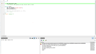

  • Thank you for the link.  I download the 2 examples/folders.  One of the examples seems to produce an error.  When I "Build and Debug" the example "ble_app_uart__saadc_timer_driven__scan_mode", I see the following.  I'm using nrf52840 DK.
    Not sure if you can see the picture.  It seems to indicate a "Fatal error".  The error code seems to be 5.  I am new to Segger, so if there is something I can provide to help, please let me know.
    Not sure if it would be related:  When I tried to import the example from the "arm5_no_packs" folder following the directions from the link above (https://www.nordicsemi.com/DocLib/Content/User_Guides/gsg_ses/latest/UG/gsg/intro    section 8.2), I changed the "Linker" from Segger to GNU.  I also made other changes to the IDE, so I uninstalled/reinstalled Segger today.  The error is still there.
    Thanks.
  • Try to modify saadc_callback() so it looks like this instead:
            ret_code_t err_code;
            uint16_t adc_value;
            uint8_t value[SAADC_SAMPLES_IN_BUFFER*2];
            uint16_t bytes_to_send;
            // set buffers
            err_code = nrf_drv_saadc_buffer_convert(p_event->data.done.p_buffer, SAADC_SAMPLES_IN_BUFFER);
            // print samples on hardware UART and parse data for BLE transmission
            printf("ADC event number: %d\r\n",(int)m_adc_evt_counter);
            for (int i = 0; i < SAADC_SAMPLES_IN_BUFFER; i++)
                printf("%d\r\n", p_event->data.done.p_buffer[i]);
                adc_value = p_event->data.done.p_buffer[i];
                value[i*2] = adc_value;
                value[(i*2)+1] = adc_value >> 8;
            // Send data over BLE via NUS service. Makes sure not to send more than 20 bytes.
            if((SAADC_SAMPLES_IN_BUFFER*2) <= 20)
                bytes_to_send = (SAADC_SAMPLES_IN_BUFFER*2);
            else
                bytes_to_send = 20;
            err_code = ble_nus_data_send(&m_nus, value, &bytes_to_send, m_conn_handle);
            if ((err_code != NRF_ERROR_INVALID_STATE) && (err_code != NRF_ERROR_NOT_FOUND))
            m_adc_evt_counter++;
