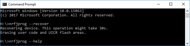

    I suggest to use our command line tool for programming:
    https://www.nordicsemi.com/Software-and-Tools/Development-Tools/nRF5-Command-Line-Tools/Download#infotabs
    Then you can type for instance 'nrfjprog --recover' to erase the chip, and 'nrfjprog --progam filename.hex' to program:
    If you have issues programming I suggest that you make sure to pull reset pin to VDD and call 'nrfjprog --recover'. It is a common problem that during development sometimes you enable pin reset and set the pin as low output, then it will go into a reset state until pulled high externally.
