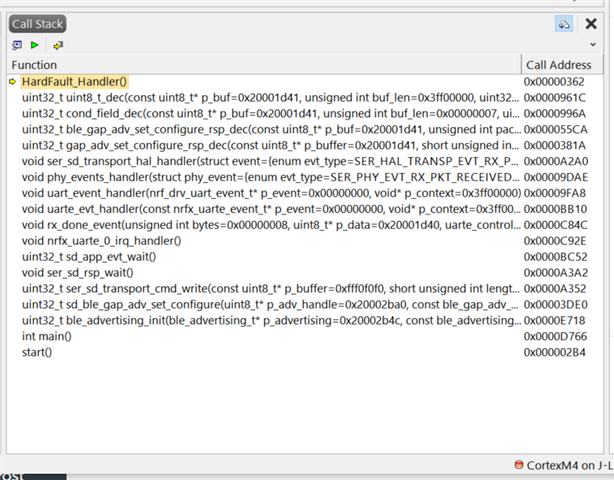

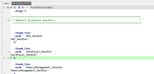

If I simply switch to SDK v15.3.0, I get a hard fault early on:
I see the same results if I use a pair of Rigado BMD-300-EVAL boards in place of the nRF52 DK boards. All are based on the nRF52832.
Any thoughts?
