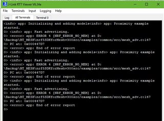

3.i enabled PB_GATT and and GATT_Feature enabled .system got reset ..or fatal error will display on console in advertising_init
   for this i changed advertising settings from fast to slow mode.

    Can you try to define DEBUG in your preprocessor defines, and see what the log says before the fatal error? It should give some more information on what error that triggered the reset.
    Edvin

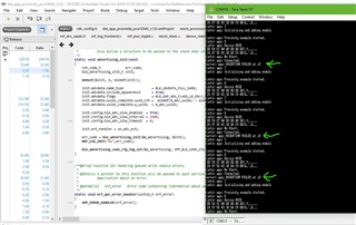

  • Hi Edvin,
     Thanks for your replyRelaxed. DEBUG macro has defined and the project built and ran successfully. We found that an error message "ASSERTION FAILED at :0" before reset event. Can you explain the causes of this error and how to fix this?

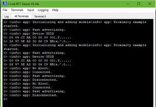

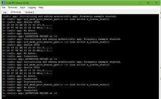

  • We have tested the ble_app_proximity_coexist with nrf52_SDK_15.2.0 as following combination,
    1. Built and tested the project with default settings, Device listed in nrf_connect and made transaction successfully,
    2. Enabled Macros (MESH_FEATURE_PB_GATT_ENABLED, MESH_FEATURE_GATT_PROXY_ENABLED), got error  and couldn't view the device in nrf_connect and mesh app.
    3. Commented advertising_init(), advertising_start(), tx_powerset() , device listed in nrf_connect and nrf_mesh app. it seems work fine. But it got ASSERTION_ERROR when we make provision through nrf_mesh app. How to solve this Assertion_Error occurrence during provisioning?(This is actual issue we told at the beginning).

  • So is 1. working as expected? Are you disconnecting on purpose, or are you having trouble provisioning?
    Are 2. and 3. attempts to fix 1.? Or are you trying to add features to 1.?
    If the disconnects are not on purpose, can you please try to log the disconnect reason in the disconnected event?
    NRF_LOG_INFO("disconnected reason %d", p_ble_evt->evt.gap_evt.params.disconnected.reason);
