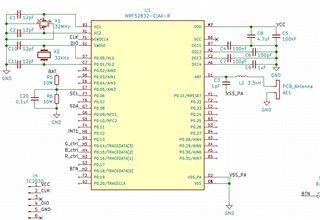

Custom board built around the nrf52832-CIAA.
Drawing 4.7mA.
VDD: 3V
DEC1: 1.1V
DEC2: 1.2V
DEC3: 3V
DEC4: 1.2V
Reset pin floating/NC.
J-Link commander (6.44a) cannot connect to target. I've used the same j-link for multiple other boards, so I know it is working. VTref is 2.99V.
I've followed the reference design as much as possible - but I don't think the issue is there. I've tried 3 different ICs & 2 pcbs. Reflowed many times. Verified SWDCLK activity on a scope.
