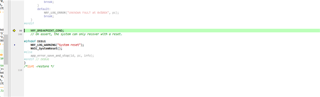

If I try to enable the over-sampling . I face an unusual behavior that the debugger goes in NO BREAKPOINT CONDITION.

    For your issue we need to find the function that issued the error code. The breakpoint you hit is inside the applications error handler that is called whenever a APP_ERROR_CHECK is run in a err_code that is not NRF_SUCCESS.
    We need the error code, line number, and file name that is passed to the error handler.
