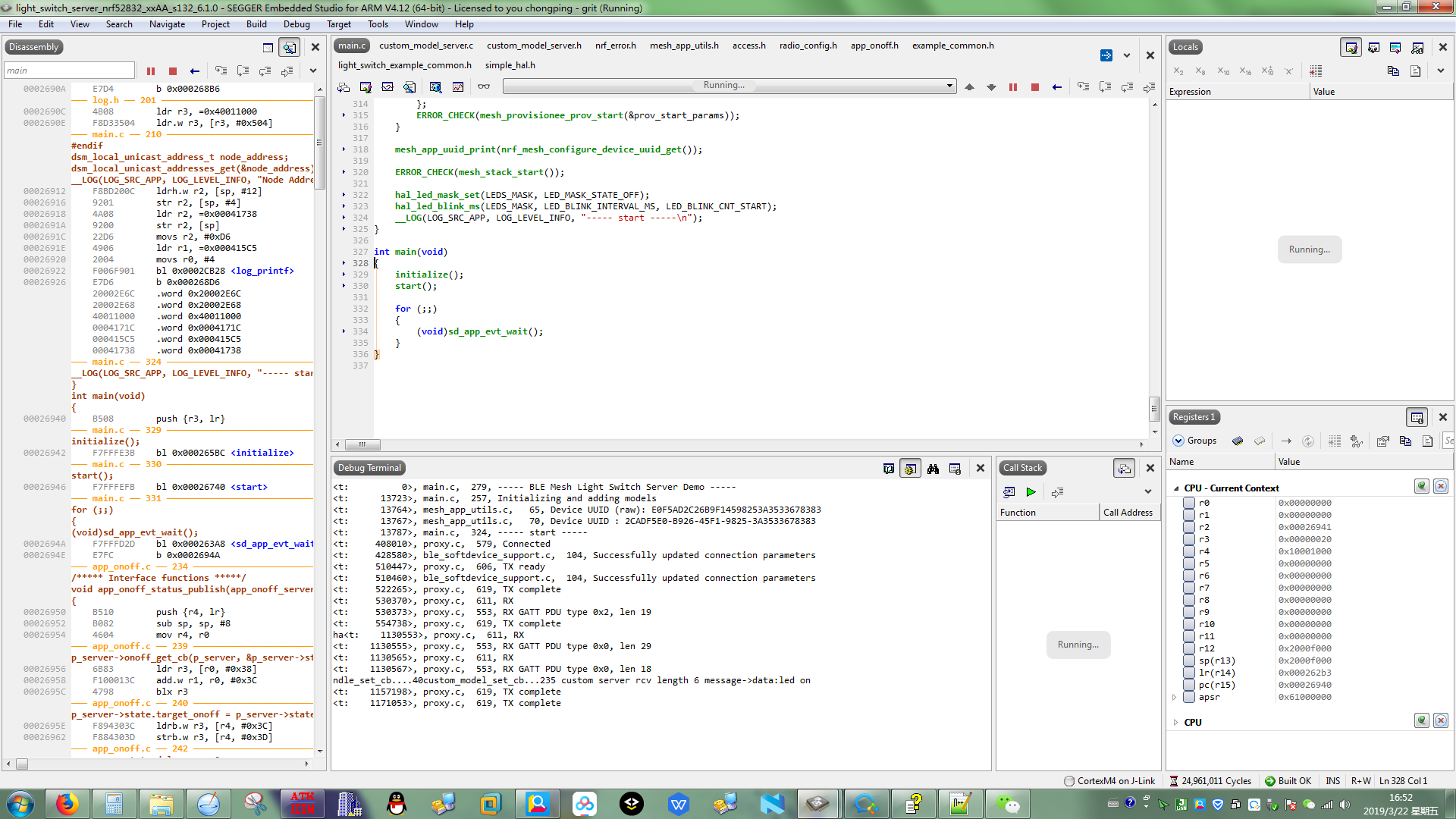

  • 1.yes ,you are right , now i create server_model successfully ,use mesh app can send message ,and it can return some message .
    2.but send from a board client_model ,it is failed , but log show it was transmitted .
    3. because i have no 2 J-LINK, i can not see the log both , when i drop the J-LINK the board seems can not run. i am so new to nrf52832,maybe i use the wrong way to download the firmware ,can you show me the wright way? thank you. i am use the SEGGER embedded studio IDE .
    debug run ok , but drop J-LINK can not run
    4.below is my client_model functions , it runs no error but can not transmit message out :

    to program you can simply press the green play-button, as you probably did. To play it safe(and erase provisioning data) you can also do "Target -> Connect J-Link" and then "Target -> Erase all". I usually only do this, if I program a completely different example on the board or if I get a Mesh assert error right at the start.
    You are using the access_model_publish_address_set-function to set the publication address. You can check if this succeeds by using the function ERROR_CHECK() on the status you get back.
    But I suspect, that before setting the publication address  you first need to bind a appkey to the model. I think this is done by the provisioner.
    I am using the nrf-mesh app on android and provision the nodes by hand. This means I do not bind the appkey as well as set the publication address in my program.
